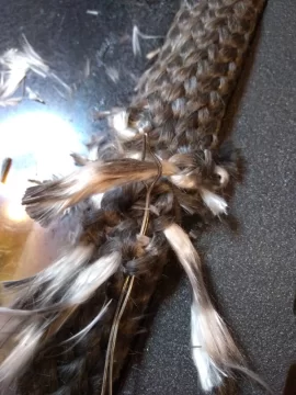

Speaking of overkill, I made a needle(couldn't find a darning needle in my sewing kit) and wove the loose ends of the outer braid to make a smooth joint instead of just butting it together AND offset the inner core by 1.5'' so the joints wouldn't line up.
