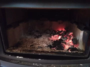

Well, we're pretty "stoked" about our new milestone. Filled it full of maple and and some small cedar pieces at 1330 yesterday and turned it down to about 3 on the tstat. When we returned today at 1600 this is what we found...
[Hearth.com] 2017-18 Blaze King Performance Thread PART 3 (Everything BK) [Hearth.com] 2017-18 Blaze King Performance Thread PART 3 (Everything BK)
...and in about 15 minutes it was like this...
It got down to 3C last night and up to about 5C today, the main part of the house was at 20C and the "wings" were 19C. So 26+ hours on one load has made us true disciples to the catalytic stove.
