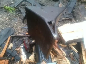

My son made this for our splitter. It will split the wood twice as fast as the thin wedge because the ram only has to travel about 1/3 the way into the piece before it splits wide open. No loss of horsepower and the slip on wedge can be removed for real gnarly pieces and then put back on in a sec. We usually put a small stick along side the small wedge to keep[Hearth.com] 4-way on MTD 21? [Hearth.com] 4-way on MTD 21? the removable wedge from rattling.
