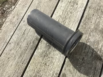

Pictures of your set up might help. Here is one of a Metalbestos, company name changed to Selkirk, chimney to single wall stove pipe adapter that I am pretty sure I used in my old garage. (When I sold I had to pull the stove, chimney and patch the roof for the buyer‘s insurance co. on the rightfully frowned on installation.)
