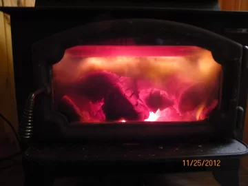

In the picture I'm burning 2 + year old Cherry, the stovetop temp topped out at 650 with the air shut down.
We usually char down the wood for 15 - 25 minutes on a cold start. What temps (Pipe & Stovetop) are you getting up to before shutting it down?
