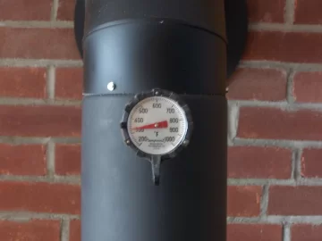

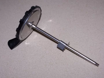

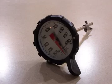

    Todd , it's a Tempoint thermometer. Used as part of an oil burn test kit. You can buy them separately. I have one for the Esse too. They can be calibrated too, hot water and check the reading. Comes with instructions. I like it because you can glance across the room to see a easy reading. Plus it's accurate. Drill a quarter inch hole, and hang the mounting barcket into that hole, then slip in the probe, it's a nice interference fit so it doesn't roll to the side, nothing, stays right where you place it. Usually 100 dollars found a place the other day for under 70. I'll try to find it again and post it on here.

    Todd , here's the best price I found, most places are 105 dollars for the thermometer.
    1. Bacharach Boiler / Furnace Thermometer, Tempoint - (200 to ...
      Manufacturer Item #: 12-7014. Your Price $68.95. Add To Cart. ... Bacharach Boiler / Furnace Thermometer, Tempoint® - (200 to 1000ºF) Add To Cart. Professional Equipment.

    Be careful with that flue probe. I use to have a teltru probe that read from 200-1000 and when the Fireview is in the bypass mode it has no problem getting up to that max temp, I had to keep a close eye on it. I've been looking everywhere for a more accurate flue probe than the Condars, I wish they made a thermocouple with a dial face.

    I originally had one for my Paxo 60 boiler, and it's been pegged a few times by accident. But I really never leave a stove once it's wide open. The Fireview had the probe to 700 in about 15-20 minutes, so I know what you mean Todd. I'll take the nice start up draft. I can tell you the drafting ability of the Fireview shames the Quad 5700 I had. Woodstock really did their homework designing their stoves. Boy Todd,,, I just love this stove, so much better then I thought it would be. Just goes to show the difference between a mass produced stove and ones that are hand built, one at a time. That would be a good Woodstock ad,,,,," After all these years hand crafting stoves, we still build them one at a time"!
