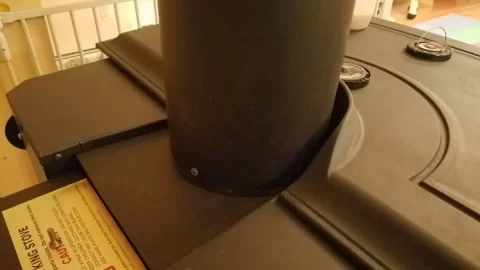

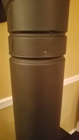

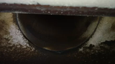

That looks like a huge space between the inner and outer pipe. This is what mine looks like. The inner pipe you can see in this photo sits tight to the collar weld and the outer pipe sits flush on top of the stove.
[Hearth.com] BK Ashford 30 Install
@AlbergSteve Wow, that is much tighter.
Unfortunately in mine there is still a little bit of crimping pipe protruding but the end of the collar is now very snug to the inner flue pipe. I spent a few hours to recut the short connector pipe section, crimped the inner tube, and basically press fitted it into the lower 45 with wood blocks and a mallet. All the other joints were tightened to the bevel. It all came together nicely :)
