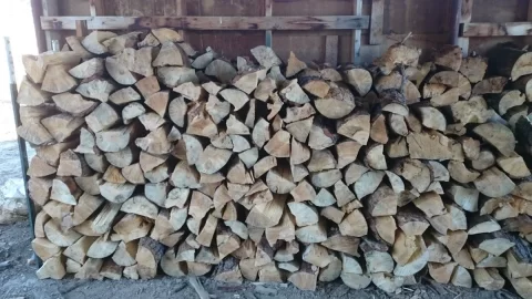

Looks good, that's after being split down farther? The back row on the right looks much bigger. When you split it, does the inside look just as dry?
From the outside it looks good and I can't imagine that fuel forming visible drips on the glass. Load her full and keep the cat active.
Some of it is new wood that was dead standing and some of it is what we already had! Some of it looks slightly and felt damp/cold. Some of it was spilt further and some of it was just cut up in hopes that it is dryer.

Good point, and I don't think this has been mentioned yet, but that's a great way to check how wet your wood is; When you have a good coal bed, throw several splits on, leave the bypass open and get some flame going in the box. Then after the splits get burning, open the door a little; If you hear hissing or worse yet, see water bubbling out the ends of the splits, your wood is too wet.
That's another indicator; If you split one and press it against your cheek or lips, and it feels cool, that indicates moisture evaporating, and it's too wet. If that's the case, I would definitely split a little smaller. You can split a bit bigger later, when you can leave it in the stack a couple years before you need it.
