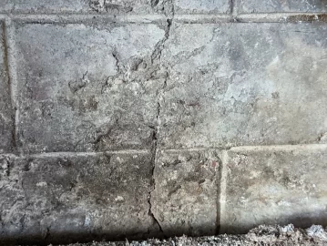

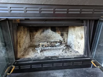

I'got a heatilator ec42 with some panel damage on the back wall. Someone is coming out next month to replace the panels but I am wondering if I can do a patch with some morter as a temp fix for the holidays. Probably 2? Or so fires unless we loose power or something. Wood fires only.
Couple of photos attached. Crack for scale is nickel width in a couple of places somewhat smaller in most of the rest. Unclear how deep though.

Check the depth. If it goes through to the rear wall, don’t burn. If it doesn’t go all the way through, go ahead. For a quick fix, RTV Silicone will work, but it won’t look very nice. Another option would be to place a cast iron fireback in there.
