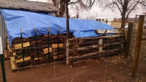

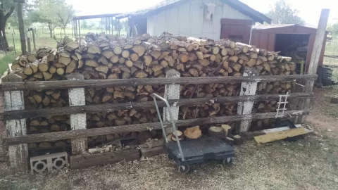

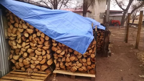

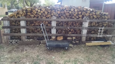

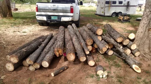

Let me make it worse for you;lol PINE PINE PINE oh, some cedar also;lol
Thanks a lot, Bud! I fell asleep in the chair, thinking about it, and when I woke up I found my skin had crawled outside and hid under my car. I had a heck of a time finding it. ;)
