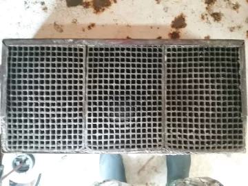

Combustor fails again in my King parlor.
ohlongarm
Mar 18, 2011
1,606
Northeastern Ohio
In 2019 I, replaced my combustor under warranty through the stove shop where the stove was purchased.
There was a proration fee at that time, the combustor was shipped from Blaze King to the stove shop.
Now this combustor has failed, I thought the combustor was guaranteed 10 years, maybe I'm wrong, I burn 24/7.
The stove shop yesterday informed me that the failed replacement combustor only has a one year warranty, so no replacement per Blaze King, I'm going to call BK today and get the fine print details. Here's the combustor, you'd think they would last longer than they do.
No cracks, nothing plugged up, no ash, can see through both sides, what's up with this? Stove shop people are top notch, as are BK people but somewhere I'm misunderstanding the warranty on the combustor. Just have to plan on replacing it every few years

They are supposed to last 10-12,000 hours. 24/7 burning for 6 months a year works out to about 2.5 years.

You get a 10 year warranty from BK when you buy the stove. After that it's the warranty of the shop (likely dictated by the cat mfg).
And as said above, a cat lasts 10-12k hrs, so you are right where one expects you to be

What do you mean saying "failed". Looks like a perfect combustor that needs some cleaning.

A combustor failure is not determined by visual inspection. Yes there can be cracking or delamination of the substrate -- that would be due to extreme circumstances such as direct flame contact or rapid cooling from not opening the bypass and opening the door. Some of that is user error and will cause premature failure.
Failure of the combustor is typically determined by degrading performance. An older combustor will take longer to light off. You simply look at the combustor thru the glass when the cat probe is at the active line and you have just closed the bypass -- see how long it takes to glow. New ones glow immediately, older ones take a bit. Also you check the smoke trails from the chimney during the middle of the burn. A newer combustor will eat all the smoke and give a clean burn. An older one with less performance will let some smoke thru and that can be seen in the exhaust.
That combustor looks pretty good. Put it back in and see how it performs based on the above. Good luck, you have the GMC Yukon of stoves right there...hehe

My dead cats look perfectly good. They don’t have to physically degrade to die.
