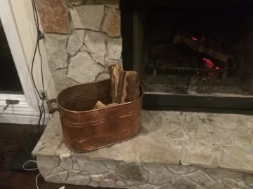

I've went through a ton of firewood also......not proud of it but to offset my propane usage and to run my propane tank to empty to replace the valves. I have been burning firewood like crazy in my prefab fireplace and puts off very very little heat.
No joke I probably use 4-5completely full loads of firewood in my copper boiler to help heat the house when I'm off work. I would estimate 250lbs of firewood a day I run it.

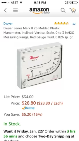

So I will 100% buy one of these. What is the meter you guys use to calibrate them? Set it and it's good?
Dwyer Mark II manometer...want one?
