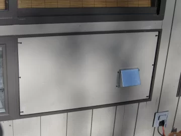

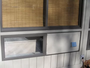

I've been thinking, reading, planning, posting, procrastinating and any number of other non-action verbs you can think of to describe my immobility. Well this weekend, with temps forecast to be in the 50-60 degree range, I decided to pull the trigger. Lesson learned: put the OAK in DURING the installation NOT after. Took many hours because I had to remove a small window and make a panel to fill the space AND working behind an installed stove when you're a big guy just adds a level of complexity, aggravation and discomfort that is unnecessary. Bought the kit from the dealer. Decided it was easier that trying to fabricate something. Came out real nice and I can't wait to see if I can detect a difference.

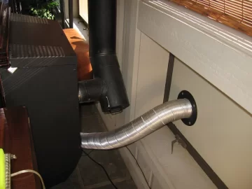

Where does the OAK pipe attach to the stove ( p61a)? None of the pictures show the back.

Looking at the back of the stove take off the lower right panel you will find the air intake

There's a tin knock-out there. Remove that and your ready to hook.

There will be schematics in your manual that will detail location of intake air connection for your stove. Position may vary from model to model and/or stove manufacturer depending on their design. If you don't have a manual, you can usually find them on line...

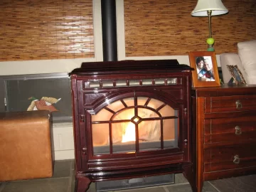

Hate to sound like the code police but is that table against your stove on the right, or is it moved for picture?
Yes, it is right next to it. Maybe an inch or two of airspace but the stove does not get hot on the sides.

Did you take a window and create a "wall" for the oak to pass through?
I did. The entire wall is made up of large sliders on the top (I think they are 4' high and 6' wide) and a pair of jalousies under each window on the bottom. I took out the "workings" of one of the jalousies (6 screws) and replaced it with a piece of 5/8" exterior grade plywood stained to match the house. I added some gasket material to seal it against the existing aluminum window frame. On the inside, I cut a piece of 1" styro to fit the hole and mate up against the plywood and stained it also. In the Spring, at the end of the heating season, I'll pull it and reinstall the window. The room was originally just a blue stone patio. The previous owner enclosed it and installed electric baseboard with the intention of only using it as a 3 season room. My wife and I love it so much we installed the Quad in there.
