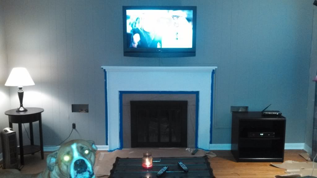

Gonna take some better pics when I get home but figured I would ask the stupid question. Looking to put a insert into my existing fireplace but having trouble finding something I like that will fit. My question is that there is an existing fireplace installed right now, the damper is already removed (rusted out) and the doors are very easy to remove. The firebox is steel and is restricting the size of the the insert I can put in as after 15" deep the back slopes up.
Can I remove this steel box? Is there masonry behind it? I tap on the steel and it sounds like there is room behind it. I will open it up when i get home and take better pics for you. This is the only pic i have available of the outside

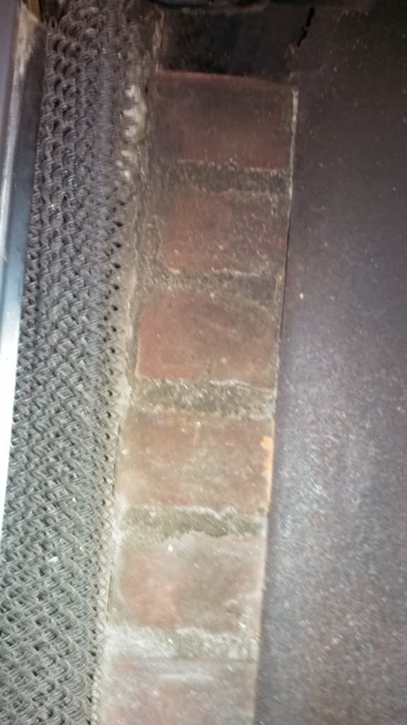

Ahh damper, that makes a difference, sounds like a masonry fireplace now. If you feel sure you won't use the fireplace ever again you could try cutting out a piece of the metal and see if brick is behind it, you got a carbide hole cutter sitting around?
I have seen people remove the metal to get a larger cavity to insert an fireplace insert into, masonry is masonry if you meet the clearance to combustibles.
OK, thanks for clearing up the confusion. That dog does look intense, must have zombie xray vision or he found a radiocactive isotope out in the north 40.

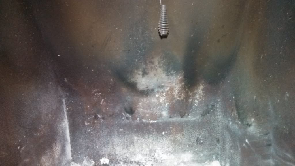

up the flue
[Hearth.com] Frustrated!
side of firebox, behind the door where brick meets steel

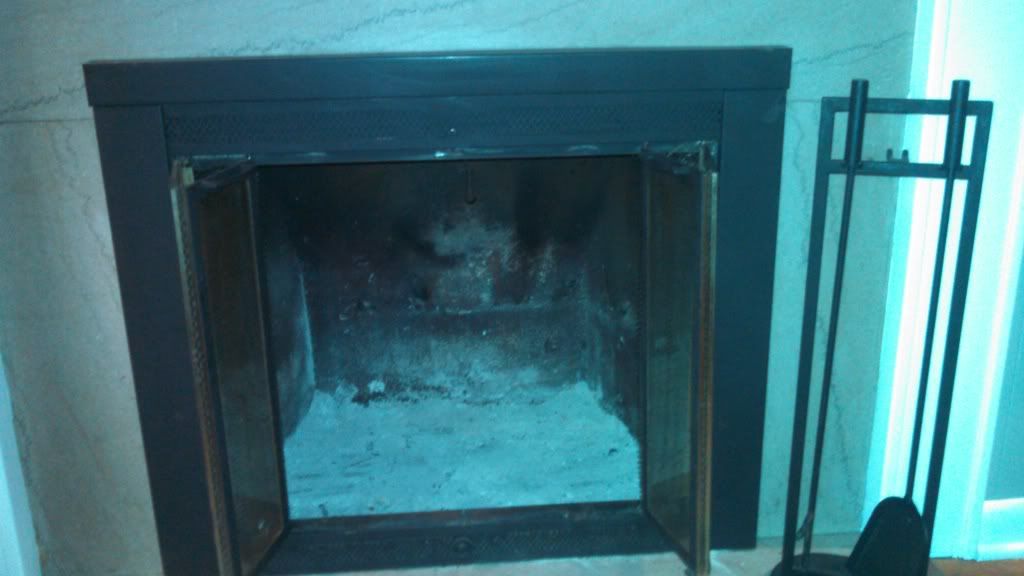

looking into the firebox

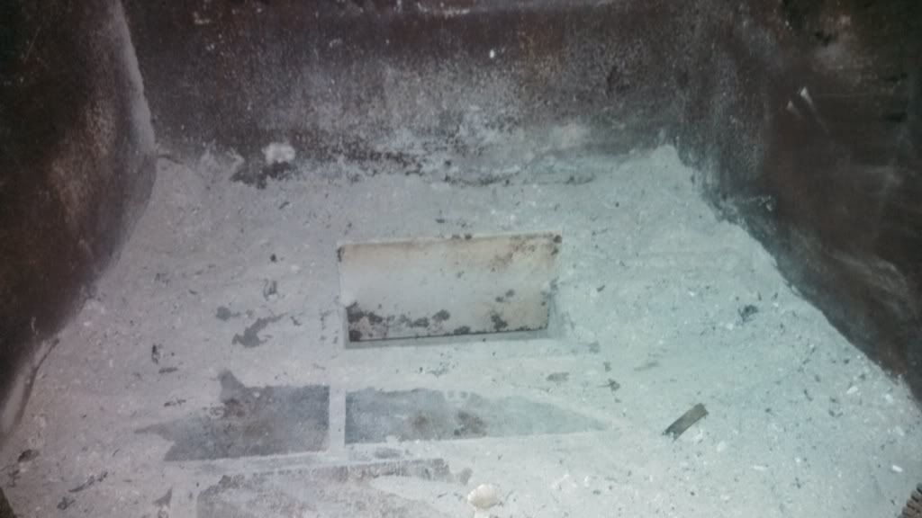

bottom looks like masonry with ash door

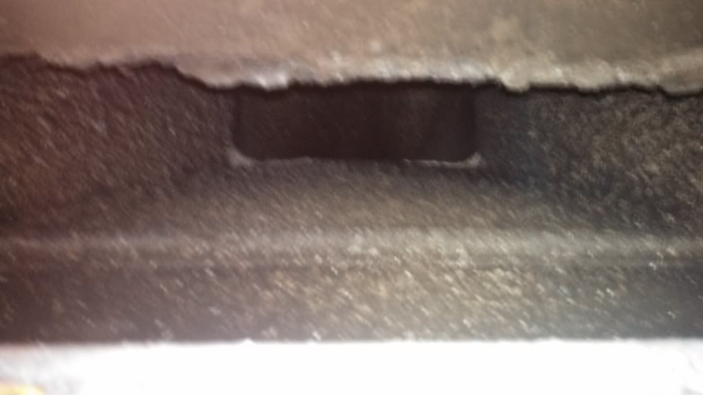

Looks like maybe an old heatform fireplace?
