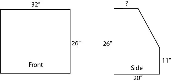

    What are the full dimension of the existing firebox?
    How big an area are you trying to heat with the insert and how open is this room to the rest of the house?
    Do you plan on night and weekend fires or burning 24/7?

    24/7 burning, 1200sq ft. Floor plan not that open but putting in ceiling fans to help move the air. front opening 32" back opening 23 1/4 height in front 26 height in rear is 11" (thats my problem)
    Looking for something that holds 20"-24" splits and will get me thru the night, also has to look good for wife

    I'm confused by those dimensions. Can you give the dimensions as H&W front, H&W rear, Depth top and Depth bottom?

    front height 26", front width 32"
    rear height 11", rear width 23 1/4"
    depth top (haven't measured) depth bottom 20"

    Great, that helps a lot. I'm not sure what the wife will find attractive, but you're off to a good start looking at Enviro inserts. They come in the Kodiak or Boston/Venice lines, the difference being the front surround trim and door.
    Just to verify, here is what I visualize for your fireplace. Is this correct?

    YUP exactly! And we love the Venice 1700 but it wont fit will it? Wonder if they make extensions for them to decrease the depth needed like VC does because I think the slope in the back will not let the unit fit correctly
