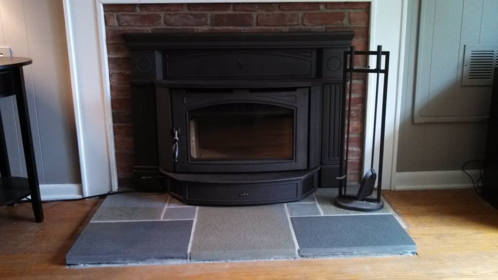

Beautiful. Looks like you'll be toasty this winter.

The install looks awesome. You folks are going to enjoy this insert a lot.

Nice looking install!

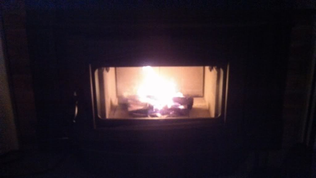

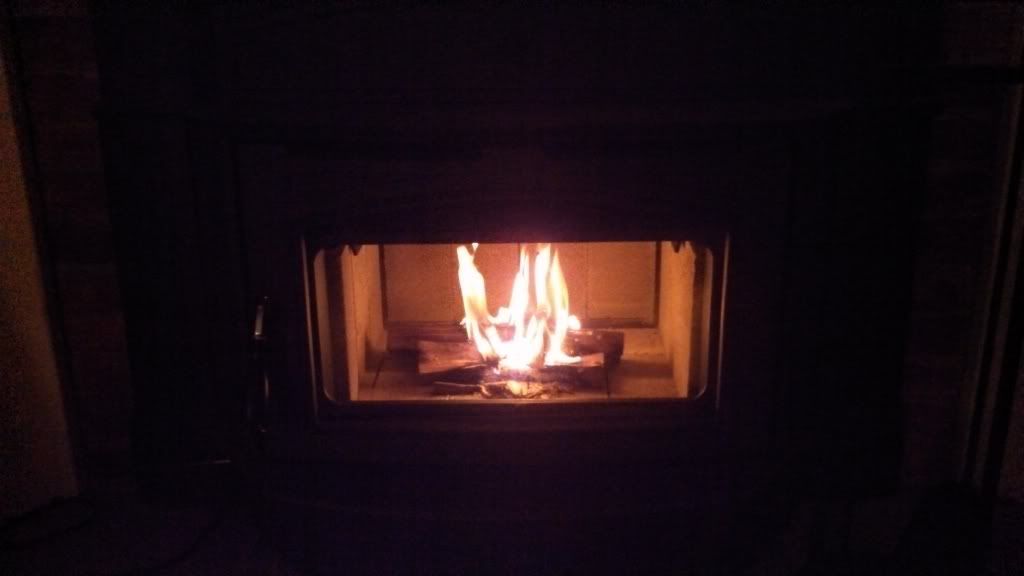

Here's some pics, I did have to crack the door for a minute to get it going, just wasn't cold enough I think. Was pretty small fire being the first break in, next one will be bigger

Hooyah!

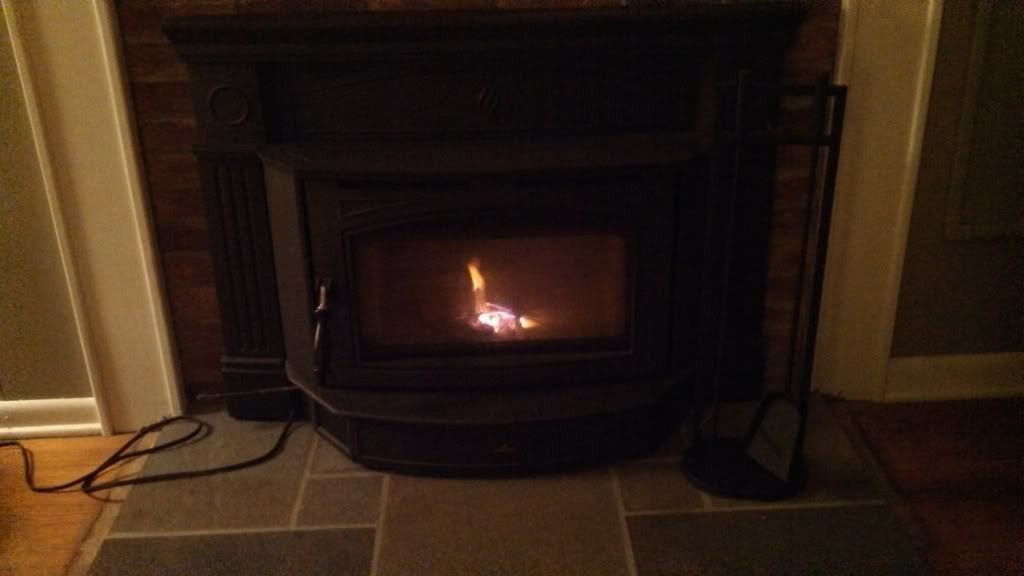

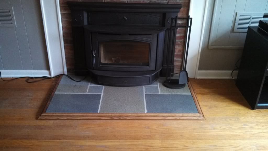

finally got it all trimmed out and ready for break in fire #2 tonight

Beautiful job. Time to change this thread title from Frustrated to Satisfied. :)
Looks great, enjoy it...
