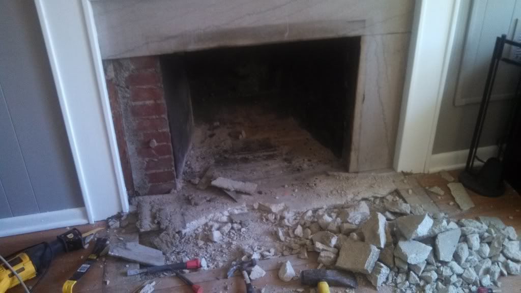

started clearing for new hearth. tomorrow I will remove the top piece of marble and cut out the floor in order to extend the hearth to code

finally got the permits today (3 weeks later). Will call the installer tomorrow and setup a day for install
Install this Friday 1pm. Can't wait!
