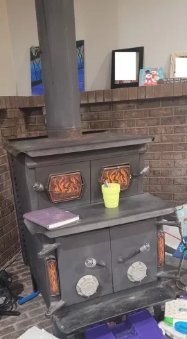

Morning Everyone!
We bought a house with a beautiful fireplace in it but there is no identifiable markings. Was told it might be a blaze king but in contacting them, they said it's definitely not one of theirs. It doesn't have the backplate anymore which is unfortunate because insurance has to label it as a home made unit which requires much heavy heat deflection (steel sheeting with air gaps) on the walls, underneath, and ceiling. Would like to have a brand for it so I can get another inspection done under the manufacturers specs.
Anybody identify this beautiful piece?

Looks like one of a thousand Fisher knock-offs. The Fisher draft wheels are different, but otherwise it uses a lot of similar concepts. If the venting system is good, you'd probably do well to eventually replace it with a modern stove.

It looks professionally made. The ceramic inserts look like Blaze King, so I can appreciate the guess. Early Earth Stove?
Is there an oven in the upper section?

Similar concept, but no draft wheels or spring handles. For the record, I wasn't saying it was a home-grown design, there were many companies in the 1970's making stoves that borrowed on the Fisher concepts, my eye really caught the draft wheels. Not sure of the maker, but wouldn't be surprised if someone here ID's it soon.

It's a cool and unique old stove. Let us know if you find an ID. Has me wondering if the engineering team that made the first BKs was involved.

Looks like a Prestige by Dee Zee They used a ceramic insert easily confused with Blaze King the top plates are how Prestige made theirs. I believe it was the same company that made truck parts in Des Moines Iowa

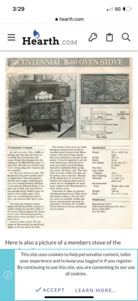

Yep. A quick Google Images search of "Bicential wood stove" confirms it. In fact, some of the images I found have the word "Bicentennial" cast into the ceramic inlays. Looking again at your first post, I believe I can see the same in your image.
