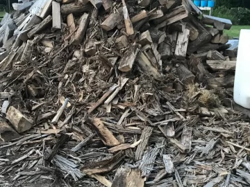

I have use of my uncles firewood processor for basically maintaining it and storing when not in use. I ran a hundred ash trees thru it last winter, haul that home and dump it, then shove into a big pile with the tracked skid steer, ash trees are getting bad enough by time you process it, run it up the elevator into the dump truck, dump it on the slab, then shove into a pile, the bark comes of and ends up in the pile, bark in the pile prevents drying as it acts like a sponge and blocks any airflow.
View attachment 201041Untitled by Marty Lappin, on Flickr
Hmmmm. that photo looks more like something I would mulch my garden beds with than put in my woodstove!
