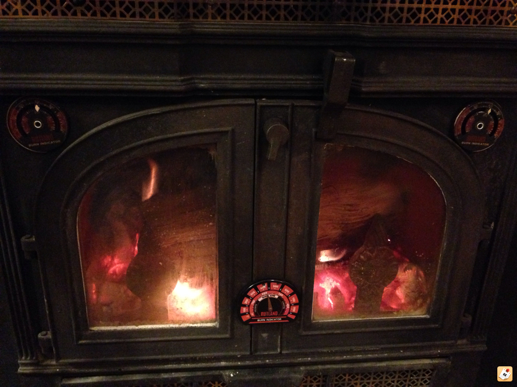

These are my coals, and it's been nothing but coals for about an hour, but it is just now getting down to 400 F on the left side. So it is time to throw in another full load.

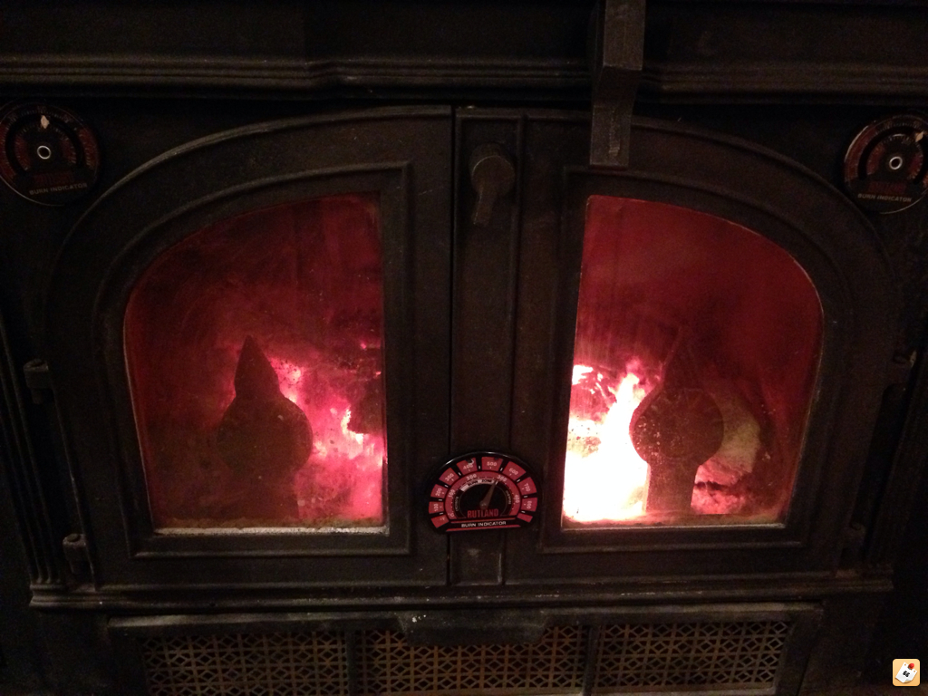

Loading on a hot bed of coals spread out Like that, You need to start dialing it down pretty quick to keep it from rocketing up like that
