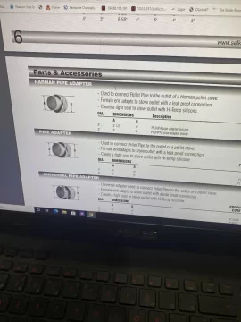

Hello folks , I’m trying assemble the vent system for my Absolute 63 .. I purchased a Selkirk vent and the adaptor don’t fit, it’s 3 inch. Seems because the exhaust outlet on the back of the stove is cast it’s OD is too large . Anyone run into this problem?

Check the part numbers on it and compare

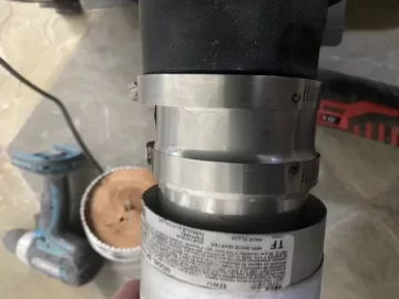

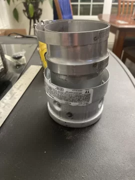

Even with the proper adapter I had to cut the top and bottom in a cm, coated the tailpipe with red rtv silicone and tightened the hose clamp down to seal it properly. Let us know how you make out.
