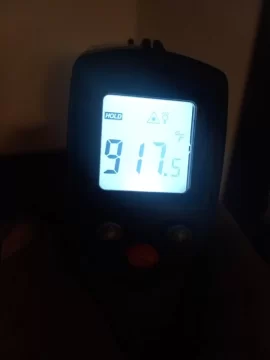

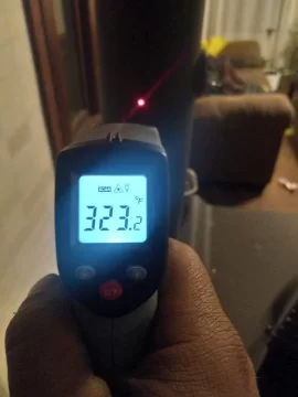

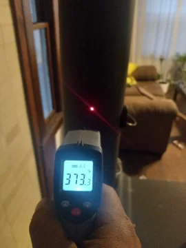

So 1st week with this stove. Vogelzang vg3200p. Same chimney same wood as old stove. ( chimney is roughly 20 to 25ft counting interior)But I am having trouble controlling this stove. Pics are from this morning when I left for work with air shut all the way down operation? Stt at 917 at hottest point. Surface temp of sigle wall stovepipe at 373 18" above flue. Is this overfire? Already have sealed ashplug so shouldn't be leaking there. Checked that front door is tight. Should I try blocking off the secondary air intake? Key damper? Or is this reasonable operation? I've learned with this stove to shut down air way earlier than previous stove. But even then it seems to burn very robustly

Yes it's an overfire. Not a horrible one but it definitely is. I would put a damper in

Yes, that is pushing overfire territory. Next load, take a picture before closing the door so that we can see how the stove is being loaded.
Don't worry and don't change anything yet. It can take a try or two to learn a new stove. This one has a lot more fuel in it. The most common issue is that people don't turn down the air soon enough. Start with that.

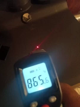

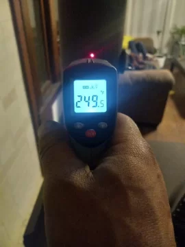

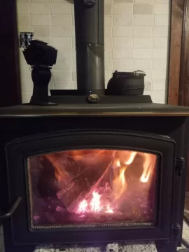

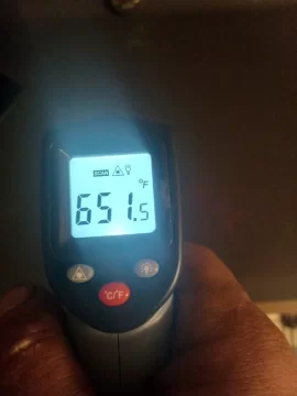

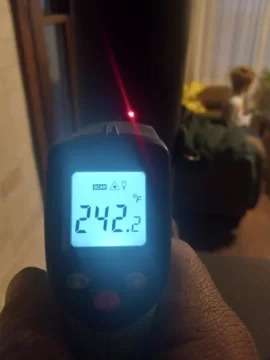

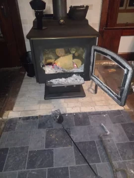

Ok here is tonight's loads and temps. Temp pics are 45 min into burn with air shutdown maybe 5 min inRaked coals to the front. Filled firebox. I shut air down at maybe 200 surface flue temp. The thing I don't get is why wouldn't my smaller stove "run away" with this chimney but this one will. This stove has 2 air intake controls and to me the 2nd smaller one seems completely unnessacary. Is it just the amount of wood that cab fit in this stove that makes it burn so hot? If key damper is the solution I will try to get one this weekend

On a hot reload, leave the boost air (right side) control closed (pulled all the way out). Just use the left side (primary) air control.
Also, make sure that the ash plug is sealing well so that no air is getting by it.

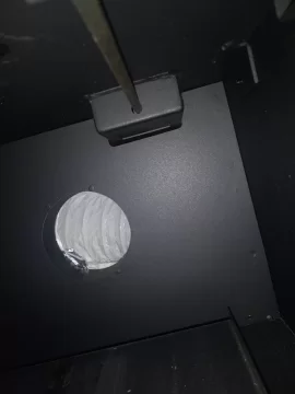

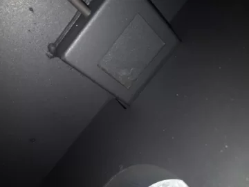

This is the boost air plate. The primary is not in a place where I can get a picture even in selfie mode. I can touch it but it's not visible

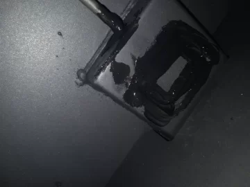

Well I sealed the boost air port. Flames instantly became more lazy seems much more controled.. flue temps down to 250. Hoping this solves the problem. Would prefer not to have a damper if possible

Wow, that is quite a change. Give it a try for a couple of days and see how the stove burns.

I haven't run this stove but what I suspect happened is that the boost air valve is loose, maybe just lying in place by gravity? If so, it seems like the vacuum created by strong combustion and draft is lifting up the valve plate up and admitting more air, even in the closed position. If so, that's a recipe for an overfire.

That could be the plate is definitely loose in the slot by design I think. I can stick my finger up on the primary plate and it moves up and down to.

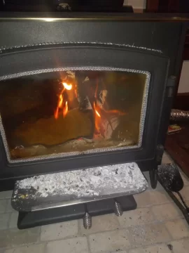

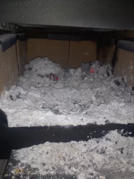

Yes still good secondaries. The pic is what's left after 12hrs. Stt in hottest spot is 244f after 12hr. It's 32f outside right now. Wife was home all day and said house was hot all day. I'm more than pleased and think 12h reload cycles will be doable down to maybe 10f depending on winds. Our house is very drafty. Poor design on the ashplug and the boost air but still overjoyed to be hot instead of cold
