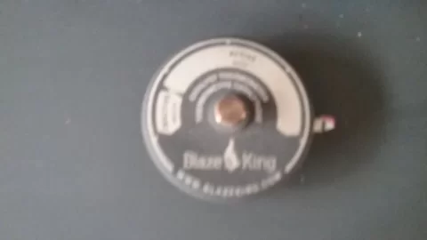

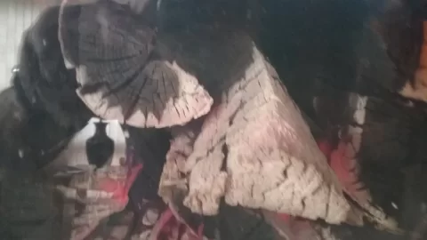

Solid load eighteen month old cherry,here goes.

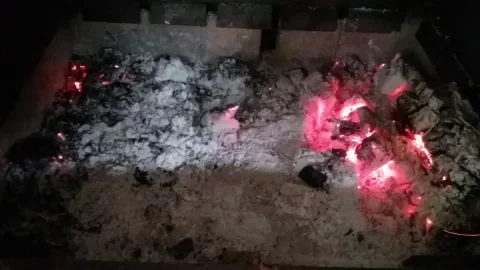

The stove burning almost no flame.

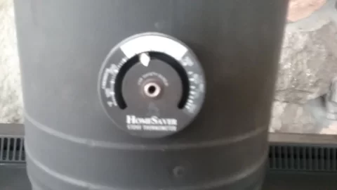

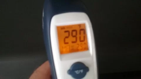

Stack temps about 275 checked with meter.

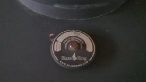

Cat is pretty much pegged.

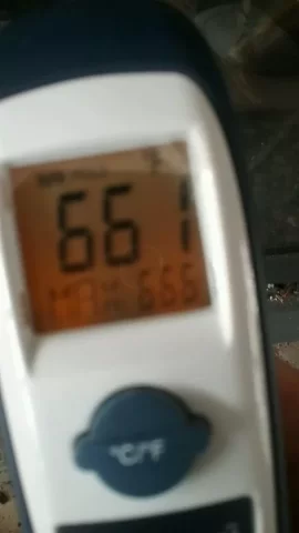

Stovetop temp taken two inches in front of the cat thermometer.
What do you guys think?
I'm sure liking well seasoned cherry,could burn it in dead of winter and stay warm.

Is that double wall pipe?
But 661 stove top temp does not sound to high to me. And what are you worried about we have been told here over and over there is no way a bk can over fire no matter what.
Looks just fine.
The cat meter goes way farther than that! You are in the normal range still.
You need to specify if the flue is single or double wall and if the reported temperature is internal or surface. It looks like a surface meter on double wall and it is much too close to the stove. Raise it up to the 18" point.
Double wall,just a note six hours later the stove top temp was 661,cat was cherry red pretty typical of what i'm used to.The new Parlor fires up quicker that the last King I had has be baffled gets up to temp in about half an hour quicker if it's real cold.
Double wall
Well you might as well take that magnetic thermometer off it means absolutely nothing on double wall. If it was at the proper height I would say that stack temp on the outside of double wall pipe would be very high but where it is I have no clue. But your other temps look pretty much inline so I don't see an issue.
