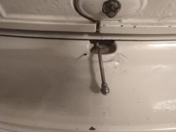

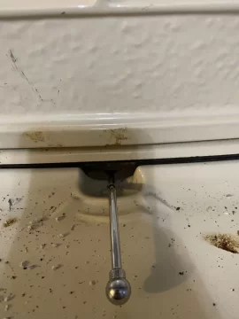

My question is the air regulation knob thingy whatever it is called.
Fully closed looks like in this picture.
I'm wondering if I need to open the mechanism and adjust it since fully closed as far it goes to the left it sits in the middle. As in the pic.
Thanks in advance.
Thanks in advance.
ON another note, when I go to the left all the way when at 550F, it will cool down properly. So I think it is fine...
You can take off the dog house air cover with the two bolts and see the control plate move to verify that it operating in its full range of motion.

While the doghouse cover is off, vacuum out the area and then sprinkle some graphite powder as a lubricant for the slider valve.
Looking at the pic closer I’m guessing that your handle is bent.

Probably, I opened it up it is using full range. I wish I had the a place I can order the euro one. Even if I can't get it here directly, I got means. And thank you. BTW, I think you got the best color castine :)

The handle easily bends. When rebuilding mine I must have bent mine upwards without noticing. When I went to put the door back on it wouldn't close without hitting the handle. I held my breath and bent it back down. I was afraid it would snap but it held up fine.
