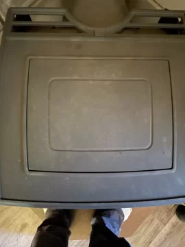

Here’s something that’s been bugging me about this stove and other Jotul’s that I can’t find an answer to. The top of the stove isn’t just a solid cast iron top. There is an inner square piece that is gasketed and has retainer clips inside holding it down. Why is this? Could you just leave that cover unhinged and use it for access to the top of the baffle? Easier maintenance? Not sure if this cover is heavy enough to keep the seal and not affect the draft? Anyone know?
[Hearth.com] Jotul F45 Greenville  Experiences
Yes, likely for easier maintenance and servicing. I believe a removable top is a requirement for UK sales. I was told that's why that Jotul tops are gasketed. They are bolted down for shipping, but the bolts are not required for daily use.
Reactions: Todd
That’s kind a what I thought. Since my stove is rear vented I might be able to go through there with a soot eater and not have to disconnect the pipe.
I ended up popping the whole top off. I’ll just leave it unbolted since there’s a gasket around it and it’s got to be about 30-40 lbs. This should make maintenance easier a I could probably sweep straight up through there instead of disconnecting the pipe. There’s no way I can sweep down from the top with my steep pitch metal roof. There was lots of ash behind the turbulators plugging those holes as well as other nooks and crannies I just couldn’t reach with my vacuum.
