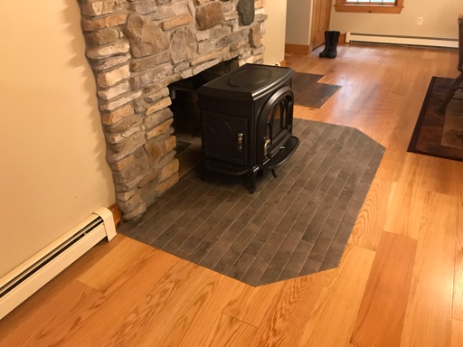

Just starting my first season as a wood burner. Running my Jotul Oslo right now, its been going for an hour and 20 minutes. Stove top is just over 550, seems to be burning good. With the air control lever all the way down the flames are still quite intense. I am getting flames shooting out of the secondary tubes, but the flames on the logs aren't lazy like I read about they are fairly intense. The air control lever doesn't seem to affect the flames a heck of a lot, I can from full air to 3/4 closed without choking the fire much at all. Stove is brand new, wood is fair, not perfect. Chimney is about 27 feet insulated interior SS liner. Rear flue exit. Temp outside is about 49 degrees. What do you all think? is it running good?
Nice. That looks like normal secondary combustion mode. Next fire, try closing down the air as soon as possible without completely extinguishing the flame.

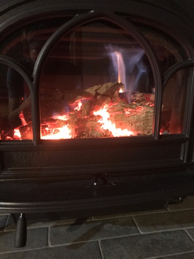

Thanks, I will try that, I started closing the air at about 450 degrees on this burn. I’m at the 2 hr. mark and most of the active flames are gone, I have some whisky blueish flames now and bright red logs. Stove is now about 425. Burn time seems a little short but what do I know.

You probably don't want a long burn time right now anyway. As the season continues you will get better at getting the most heat out of the wood.

Where was that measured, stove top or stove pipe? The stove top takes a long time to warm up. With the Castine I could start turning down the air at 250º on a cold start up. Not all the way down, just about 50% or until the flames got lazy. Then let the fire regain strength and close it down again. A flue thermometer is a better guide for more consistent timing of when to start closing down the air.

That is the stove top temp, I don’t yet have a flue pipe gauge. I have 100% stainless pipe and a very short horizontal section coming out of the stove before it goes up the chimney flue, so not a lot of room to put a gauge
I am anticipating a extremely strong draft and thinking of using some aluminum tape to partially block off the air intake if it becomes a problem
Shut it down fully and see what happens after 30min. Sometimes it takes a bit to see the change if its roaring hard when u shut it down.

It may be better to go by visuals without a flue thermometer. There is a lag time getting the stove body up to temp unless on a warm reload. Start turning down the air once the fire starts burning robustly regardless of stove top temp. Turn it down in increments as mentioned above.

Yes, once the mass of wood is fully heated it is going to outgas rapidly and secondary combustion will be robust. That is why turning down the air as quickly as possible without squelching the flame completely works better.
Get used to the stove before considering modifications. Is this a version 2 or the new version 3 model?

It is not the new hybrid Oslo so I guess it’s the version 2, I bought it earlier this summer. I will definitely try turning down the air as soon as the fire becomes robust next time.
