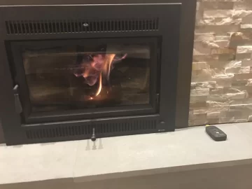

Maybe its because I'm new to burning in an insert or anything other than a 30 year old stove. Any tips on getting the temp up? I usually light the fire with Cat bypassed and vent open all the way. Once it is burning hard, I engage the cat and start to back the air flow off... am I doing something wrong? I know the wood is a bit wet (24-28%)

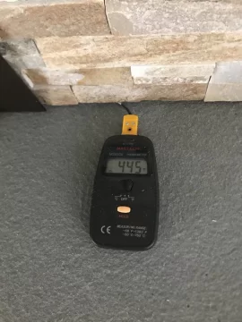

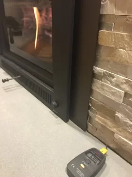

Your best bet is to get a probe ona top and develop your technique based on consistent readings . Pointing IR gun at different spots will give you an idea about temperatures and nothing more . Or you can get cat probe temp and install it if it's easy to pull insert out .
Meanwhile just wait until all wood black and burning hot and close bypass then .
You can place stove top thermometer behind grills but it's a pain to read it after that . Brother,I went trough all stages you going trough . ... IR gun, magnetic temp on surrounds etc . Remote probe made my life easier . Now my wife can operate stove without me based on temps she sees

Glad I'm not the only one! I appreciate all the advise. I'll get remote probe, where did you put the probe end?
I think I'm closing the air intake too soon and the wood isn't hot enough. Sound about right?
I tried something today, hopefully this is the correct way. I let the fire get nice and hot then closed the cat but left the air intake all the way open. I got the air temp coming out about 350 and then started to close the air intake. Is this a better way? Kind of like cruise control on the car. Get to speed and then keep it where I want it.

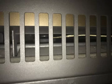

I put the probe between outer shell and firebox on a top of firebox , in a space you can see behind grills . I put magnetic top stove thermometer on a top of it to keep in place . Thermometer takes guessing out of the game and gives you piece of mind when you are burning hot . I see temps climbing north of 800 : I put blower on full speed , shaves 100f in no time .

Yes , if you can get to the left side of the stove and drill a hole trough another designated hole in a jacket. I have no space to operate there and I don't want to pull insert out since I had hard time with aligning my liner with insert in a first place. Did you call Travis directly or went trough the dealer?

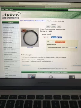

Hey man. What is the type of Cat probe is that? The brand and how you use it would be awesome. I have been looking for something like this that I do not have to drill a hole into the stove body. Thanks!
Hey, it's not a cat probe it's just a K type probe I placed on a top of firebox behind grills . Best thing ever . I didn't want to drill a hole in a firebox as well. I connected it to cheap meter from eBay , works just fine . Now I don't need to guess about temps . And it's easier for my wife to operate now based on readings. 9 v battery goes a long way for it.

Just get the right probe , the first one I got was destroyed by temperature . Get it from AUBER instruments , they have meters as well , but it somewhat ugly and expensive . I got cheap from eBay to see how my setup would work and it's still fine .
