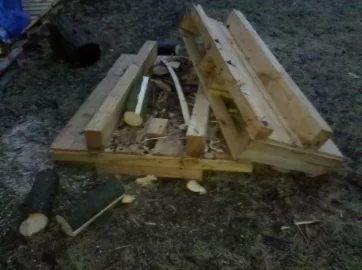

Hmmm, something like these pallets, but don't know if it would be worth the effort cuz trees are already on the ground

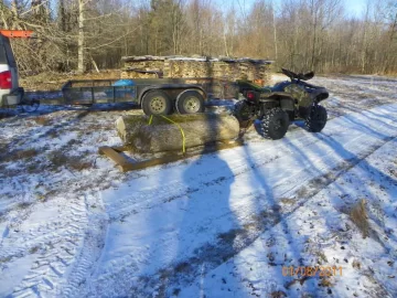

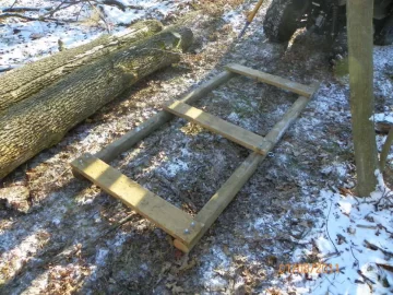

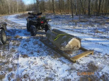

First off I don't like dragging logs on the ground because it gets dirt in the bark which will really dull your chain fast. Also, the logs drag easier using a dray or sled. I built this dray using nothing but scrap lumber. The two landscape timbers were 2 that I picked up from a neighbor who said, "Take them." I did buy some bolts and the total cost was less than $10. Skidding with this is super easy. You probably notice I put eyebolts on both sides so we can use a ratchet strap to tie down the logs. Using this dray I never had to use 4wd even going through some mud and even on the uphill grades. Loading it is easy. Many times you can just lift one end of a log and put it on then lift the other end. If you have a bad back like me, it is even simplier to just use a cant hook for loading.
If you do have to drag some out to the dray, then a small chain with a grab hook on one end and a slip hook on the other works great.

Well The pallets are like a ready made sled, flip it over trim and lighten it up, shape the front of skids, and if you look close U can see the bolts are already in there.

Sorry, I should have got a picture of the front of the dray. The front of those landscape timbers are slanted and if you use your pallet idea you will want to do the same thing to keep them from digging into the ground.

That's what I meant by shaping the front, like the front of sled runners, cut a 45 or so on em

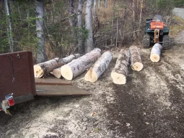

Sometimes I use a pulley chained up high & pull the logs with the truck right to the trailer.

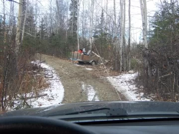

Sometimes all the way with the ATV

I saw the deal ya made for the back ,in another thread
Wish I had an ATV ,(had one ,long time ago)I would take it out there 5 mi away and drag all the stuff out, take it back home

Although that dray would work best with an ATV ,
I still think it might work. To pull some logs out from where I can't get in which the Jeep, And also keep from getting more dirt and mud Into the logs .
How does it do running over other sticks in crap laying on the ground ??
How long is that one you built, and what size. stock did you use for the top pieces ??
Did you use lag type eye bolts or drill through with nuts ??
I have a bunch of pallets with two by sixes and such, 2x6 , would be good for the top, I would think
The pallets in the picture I put up, I had to cut smaller at the site be able to pick him up and load them, I can get more which have longer skids on them, I would just take them apart on site instead of cutting them up.
Take apart a couple of the long pallets you mention you can get. Double up the long 2 x 4 sides for your dray. Nail or bolt them together. Bevel the front and rear bottom edge (like a sled). Once you start building it, ideas will flow, and you will make due with what you have from the pallets or laying around. Good luckl with the project, sounds fun. Be sure to take a few pictures to post for your buddies on Hearth.com.
I'll try to remember to take a couple other pictures today if possible. The dray can be made to practically any size and we used to haul a larger one behind a tractor. We even had a big one we hauled behind a dozer when a tractor would not work. Naturally as you would expect, that was in some terrible mud. But yes, the size I built is about right for the atv and pulls amazingly easy. That is one of the big benefits of a dray. It has no problem going over any crap on the ground but I don't think I've went over anything over 4 or 5." I used lag type eye bolts but if I ever replace then I would go with bolt type. 2 x 6 were used for the top pieces and the size was determined more from the size I had laying around. It could easily be built wider with no problem.

Backwoods, do you have eye hooks on the front of the dray where the 45 Deg ends are. Trying to figure how and where you attached the chains. Thanks.
Yes Ken. If you would like some close up shots let me know and I'll get them tomorrow.
