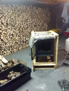

Well, I finally decided to upgrade to a new woodstove. Picked up the Drolet Austral II.
Here she sits in the crate awaiting some attention:
[Hearth.com] My first EPA woodstove...The Austral II
Gotta wait to get some help to lift her off the crate....these suckers are heavy!!!!
Installation should be straight forward. Teaching myself and the more particularly, the wife how to operate it properly may be the most difficult task of all!
Reactions: BlackGreyhounds
Congrats! Just feed it dry wood and you will be nice and cozy this winter. Do you dry your wood in that room and how long has it been sitting there?
Its been sitting there for over a month now. All black spruce. Feeling a lot lighter and ends are all split. Had the old wood stove going a few times and humidifier has been running full tilt.
Hmm, I know it is just spruce and relatively small diameter branches but I am not sure that wood is dry enough for an EPA-stove. Have you split a few pieces in half and pressed the pins of a moisture meter in the center of the fresh surface? That should read below 20%.

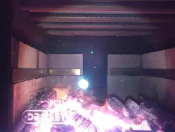

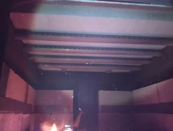

How about pics of the inside of the stove. I am curious of the new design?
Heres a couple pics as requested:

Good as I could get considering shes been running since install.

Thanks for the pics. Looks like they did a nice job with the redesign.
That baffle board looks pretty thick and will provide good insulation properties to hold the heat up around the secondary air tubes for a better cleaner secondary burn.
I wonder why they got away from the welded baffle/secondary system?? I like that you can replace tubes but with the welded system you really wouldnt ever need to.
They had to meet new emission standards by the government. If you notice they also added another row of fire brick. The baffle board and the added row of brick makes for a more insulated firebox. Keeping the heat up higher up around the tubes and preheated air coming out of those tubes to more efficiently burn the smoke up in the top of the stove under the baffle. The older designed stove was more of a heat radiating monster as the stainless un-insulated baffle and not having firebricks all the way up the sides made for better heat radiating stove but loosing that heat made for a grams of emissions rating around 5.7 grams just passing the old standard. The new design is at 4.47 grams emissions.
Yeah, the baffle board is fairly thick...1 inch, maybe even 1 1/4 inch.
