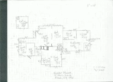

The stove/oven/gas range is going to be 10 " away from the side of Elvis. I don't think it's an issue, but am asking, just incase, while there is time to change it.
I leave it to the experts but there ain't gonna be any gas appliance just ten inches away from a wood stove in this joint. I don't know what rule should apply and wouldn't care.
Ok, I just talked to the Dixette, who was able to do some measuring.
The distance from the side of the Timber Ridge to the side of the range would be 16". Range is 30" wide. Facing the front of the range, the wood stove would be to the right. The gas line is on the left side of the range (w/electronic ignition), located at the back lower left corner.
I've read & reread NFPA, town code, wood stove manual, and come up empty.
Plan B ... move the stove 10 ' away to it's original location, and replace the kinked copper piping with a new line. Shorter run for the copper from the tank.
Gas range will now against the bathroom wall. Wood stove is between the back door and the window.
Had to check a bit myself . . . according to our Inspector he doesn't know of any codes that stipulate a certain distance with woodstoves and gas appliances . . . he said in this case he would check with the woodstove clearances and check with the gas oven clearances and insure that both clearance requirements are met. He added that there shouldn't be an issue having the two appliances close to each other (providing clearances are met) . . . but he added that he would personally be a lot more comfortable having the two appliances being separated from each other in terms of feet rather than inches.
Thanks for checking, Jake :)
Plan B it is, with the gas range now being 12' or so away.
