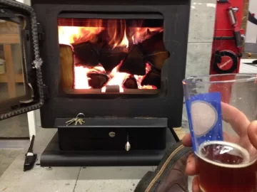

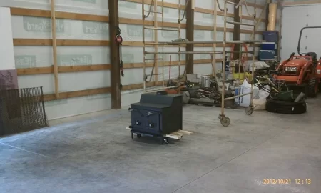

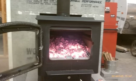

Just looking for strategies to burn these down furthe.
Do you have any Pine in your stacks? I run a small (relative since my insert is tiny) load or two of Pine to burn down coals.
I like the set up you have in the shop highbeam, looks like the perfect hideout, except I do not see a beer fridge>>

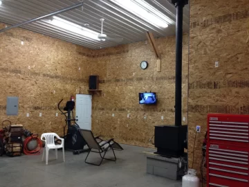

There's a beer fridge. Just a little dorm sized one to hold two 5 gallon kegs and the gas bottle. It's in the little room behind the stove.

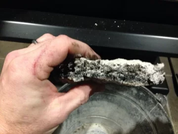

I get the clinkers also. Usually in the front near where the boost air enters. I'm thinking the jet blast that comes from there occasionally is so hot, it bakes whatever minerals in the wood and ash to form those clinkers. I had one bigger then my hand opened up, and about 3/4" think the other day. Makes for easy scooping thought. Almost like a huge chunk of used kitty litter.
