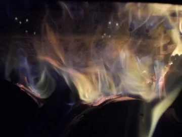

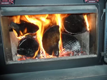

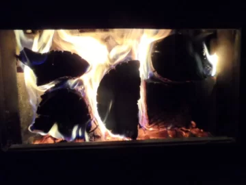

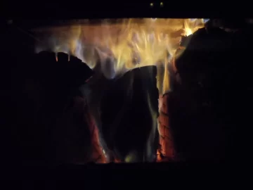

Poplar, the other white wood.........
Not so hard on the coaling and lots O heat, Estimated burn time 5-6 hrs. Just in time for midnight full load of oak.
This is how I burn span between hardwood long loads on the colder days.

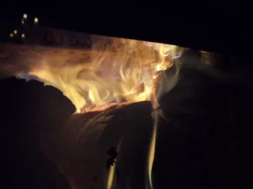

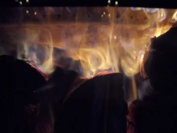

Yes that is a crack on the baffle face.
The new design baffle seems to bow upward at the front now, instead of sagging down, design? Who knows. The belly still sags down some, but they have added stiffeners inside.
Seem to remember seeing the same bow upward on someone elses photo.
I swear the baffle is shorter front to back, I'll have to measure between the A body baffle and B body baffle.
There are some baffle design changes I took photos of, but didn't get to post yet.
