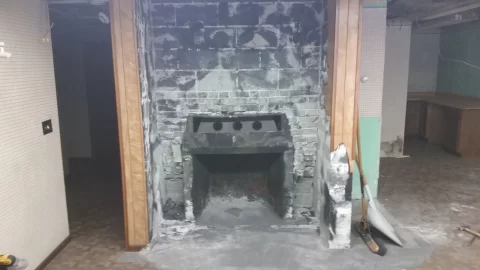

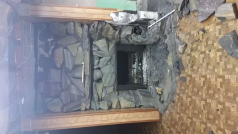

Before and after photos of my project on Friday. This is the DS fireplace
The liners probably should be insulated. Inspection requirement is up to the local jurisdiction and insurance requirements.
That is an old heatilator fireplace by the looks of it.

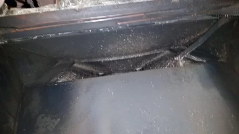

Yes it is. Both of them are actually. Will that be a problem for the upstairs insert? I plan on using the Sawzall to cut out the firebox and insert the princess.
I can see cutting out a heat tube to clear the liner, but why cut out the firebox? That doesn't sound like a good plan or a safe install.
I have enough room, but I have to cut out the damper to make room for the liner. The bottom is some type of brick deal with an ash drop thing in the back bottom.
OK, cutting out the damper is common. Cutting out the entire firebox is a no-no.
