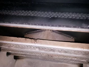

I just built a new house and had a Lennox Brentwood installed. After not much more than three to four weeks of use, the top refractor suddenly has a very large chip missing from the top/front...it looks like a deep gouge, about 1/3" wide and equally deep. It looks like it was gouged with something hard, but I know I didn't do it, it would be difficult to even hit it in this spot because it is above the air tubes at the top of the unit. What would cause this? It seemed to happen overnight. There are other small "gouges" around the larger gouge.
The side, rear and bottom refractors seem fine.
Incidentally, the internal fan/blower stopped working the same night this happened. Is it possible for the fireplace get too hot and damage the refractor?

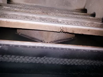

For some reason this picture is upside down...
Also, is there a better fan that I can use with a Lennox Brentwood? The standard squirrel cage fan is noisy, and doesn't move all that much air.
The chip in your baffle looks unsightly, but I wouldn't worry about it. I doubt it's caused by heat. Looks like somebody struck it with a very hard, pointed object. A replacement bower would have to meet the same physical dimensions of the OEM & be adaptable to being wired into the existing electrical system...
Flipped pic:

I agree, it doesn't appear that the nick will affect the stove operations. It looks like somebody tried to stuff that last little splinter in for an overnight load and missed by two inches.

I also have a Brentwood, this is my 5th winter with it. That same edge on my baffle is kind of beat up and rounded off, I wouldn't worry about it. I think you are the 1st Brentwood owner I have seen here since I started visiting this site. If you are new to burning you can learn a lot here. I have burned this stove hard would be glad to share my observations if you are interested. I agree the fan can be annoying. I mainly use it to get the house up to temp, than I can generally keep it there without it. Ceiling fan is the key there and my house is a wide open loft.
Thanks for the tips everyone! I appreciate the help. The upper refractor seems very soft...I can scratch it with a stick. I assume that is normal? It is not nearly as hard as the sides, rear and bottom. Maybe it is a lighter material since it is spanning a long distance?
