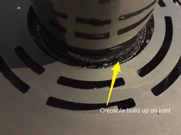

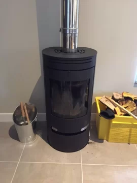

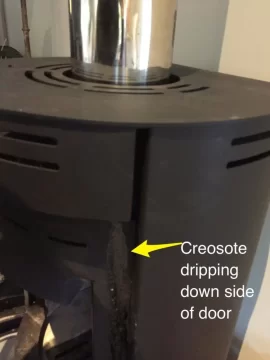

Thanks to each of you for your help! Here are some pics...

if you pick at the goo, can you verify that it is consistent with plastic as your installer suggests or is it really creosote?
you can usually just snap in two a splinter of wood to see if it's so green it would cause your stove to expel such an abundance of goo. It should be easy to tell if it's plastic or not.
do you have stainless steel appliance adapter between the stove collar and class a pipe?
The installer seems to be stalling. Plastic and creosote are very different materials, but regardless whatever is in the pipe is supposed to flow back into the stove. The way to do that is to have the pipe's male end inserted into the flue collar. Allowing that tarry substance to fall on the stove top is dangerous and must be fixed.

Stove installer should remove all creosote deposits and drips on the stove, then touch up the bare metal areas.
