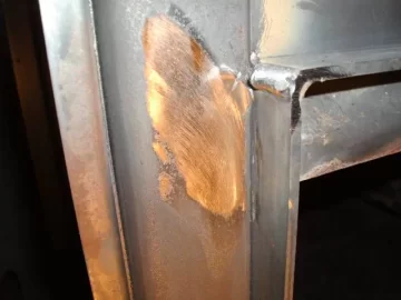

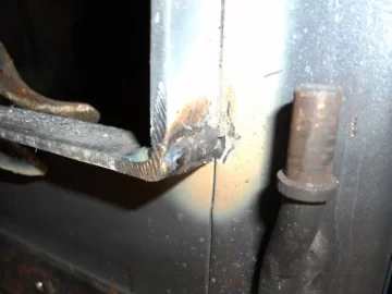

Here is a some photos of mine when it happened.

Repairs
  • [Hearth.com] Pacific Energy Pacific Insert Cracks

Repairs

Finished repairs

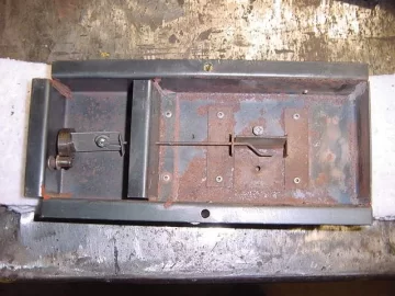

The face cracks that came back, that I filled with furnace cement.
They did make changes in the next body styles B&C. They sent me a new B. The one difference I noticed was the air wash plate at the front inside the door, was full length and welded on both ends on the A body. The B seemed to have a small gap on each end of the air wash plating, and no full welds. I believe this was the issue with the A bodies, as it takes a lot of heat there from the air wash & the jets from the baffle, and when it expanded, it pushed on both ends and caused the outside panel cracks. I have not heard of these issues with the B&C bodies.

Hey Hogwildz, thanks for the information. I was looking at our PE Alderlea T5 last night. Although I know it's a different firebox then our Summit the construction is very similar, just smaller. Anyhow, its a B series and I did notice the change around the air wash, same as you mentioned, no welds on the outer edges. There are no cracks in our T5 BUT, the stove is newer and we only use it occasionally. The issue I see is if there is an inherent design issue causing opposing forces during the heat/cool cycle of the stove, it will always end up cracking / re-cracking at these stress points. The fact that you had a certified welder repair the welds only to have the cracks reappear pretty much confirms this.
I wonder if it would be best to grind out the welds where the airwash meets the door sides and leave it floating?
