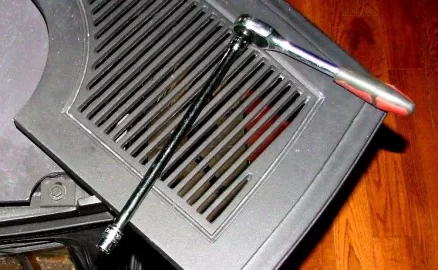

To check it out you need the following:
11mm or 7/16" socket
Short socket extension and wrench
Instructions:
Make sure the door is closed and latched

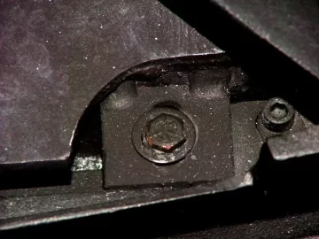

Fully open right hand side trivet
Look carefully in the corner formed by the trivet and the stove top.
You will see the head of a hex bolt sitting there (ignore the adjacent cap screw)
Using the socket, loosen the hex bolt (just remove tension, do NOT totally unscrew it).
Now apply pressure to the top of the door using something that won't catch fire right away. I used the end of a split.
While holding the pressure on the top of the door, re-tighten the bolt you just loosened.
It may be helpful to have someone help you, but I held the socket in one hand and applied pressure with the other. Some may be less handy..
After re-tightening the bolt, make sure that the draft control is closed and compare the flame activity to before. In my case there was an unbelievable difference.
