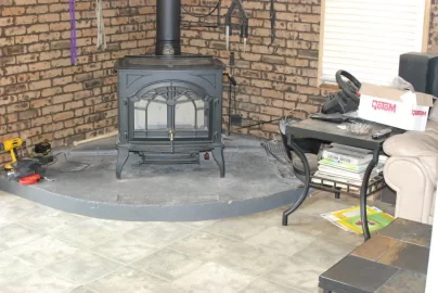

here is the new setup.

Hi Jack, Nice. Beautiful stove and pix.. You'll love the IR, a formidable foe for any large cast iron stove, Nothing burns like a Quad, there's something to that... good luck.
Looks nice, should be a great heater with an awesome fire view.
I have been looking at its 2 smaller brothers the Cumberland & Yosemite, all impressive stoves.
Looks eagerly awaiting a break-in fire.:) Enjoy
Lookin' good! :cool:
I think they usually recommend putting the flue thermo about 18" above the top of the stove, but I don't know how much difference that makes. All I can do with my setup is to lay the thermo on the tee snout about 6" behind the flue collar. :confused:
had it done by a pro gave me a list I picked it up at menards its double wall pipe and it looked like it went in with no issue.
Looks great! That looks like the same stove pipe that I put on mine. How did you attach your stove pipe to the stove? Was the diameter of your stove adapter smaller than the stove outlet?
Yep, I'm using menards double wall pipe as well. Did he glue the connector onto the stove collar? Mine had a little play at the base bc it wasn't a tight fit so I glued it in. Not sure that's the best fix but it will work for now.
Welcome to the forum, Jack. You have your hands on a pretty darned capable heater. These things breath pretty easy, so you shouldn't have any draft issues. A few things to note:
The current location of your thermo is gonna make you nervous and running for the hills is search of water. I will bet that it reads some pretty crazy numbers.
Get a stove top thermo - place in the upper left corner of the griddle plate - aim for 650F and be ready for some heat to roll off that thing.
Keep it below 800F.
Search this site for "tunnel of love" starting method. You can be shutting the stove down in less than 20 minutes using this method.
I run the primary air less than 10% open when it is cruising.
Under NO circumstance should you use the door to the ash pan for startup air. Trust me - I verified the dangers of this.
For start up - load that sucker full. Don't play around with small fires just to add more wood once it gets going.
Pay attention to the startup air control. ONLY use it for the first few minutes of startup - then close it (if you don't have the ACC).
I think you are gonna like that stove. If you have any questions, feel free to toss them out there.
Oh - and get a stove stat for the fan if you are inclined to use it.
