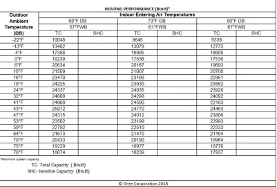

I am doing some research in adding another unit at my house with better cold weather performance. Right now Gree has the best cold weather mini split out there according to the AHRI tested ratings with a HSPF of 15. The specs on them are pretty incredible.
Here is the heating capacity chart on the 18k Gree Sapphire. It actually puts out almost 24k in the 20-50 outside air temp range. The cold weather output is pretty impressive as well.

That is definitely impressive. Who makes Gree? What is their history?

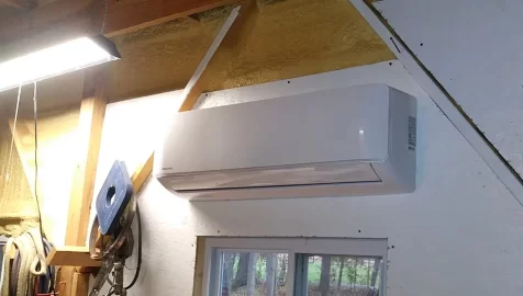

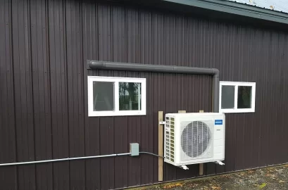

Finally got around to doing this, went with a 24K BTU Mr Cool DIY unit because I wanted the warranty and I liked the sealed pre-charged line set. $1,600 for the unit plus another $400 for mounting bracket, line set cover, disconnect, etc.
So how do you like it? 30 amp circuit?
Yes 30 amp circuit. It's been too warm to really test it, won't really know how it works until I get sustained temps below 35F or so. The most I've done so far is raise the garage from 56 to 66 in an hour with outside temps in the low 50's. 768 sq ft garage with 10ft ceilings and spray foam insulation. It pulls about 7 amps on each 120V leg.
