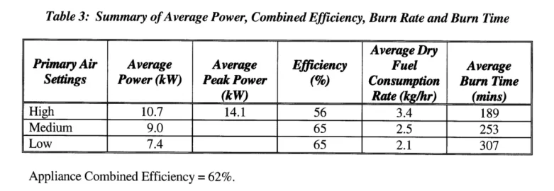

If one digs deeply the test results for the WS-18 are discoverable. Though the claim is for 86% "heating" efficiency, this is what the test report says about overall efficiency.
HRL Technology Report # HCMG/14/027
The Drolet 1800 Australian testing showed an average overall efficiency of 64% in the manual. I am still digging for the actual test report.
Reactions: TomMcDonald
Thanks. How did you find this snippet? Did you google the report number?
Yes. The report # was listed on the stove label. My advice is to get the stove you like at the best price possible.
Looks like that is an old report from when the stove was tested previously. It was recently retested. Looking at getting the updated report from quadrafire.
