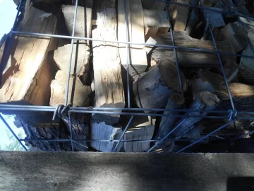

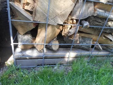

I made bins out of a pallet(s) and a hog fence panel(s) from TSC. The panels are 16' long so I cut them down into 4' long quarters, stapled the bottoms to the pallet with fence staples, then I wired the corners together with pieces of fence panel wire left over from trimming the quarters down to fit my 48" x 42" pallets.
So that I can reach the bottom of my "crate", I cut the front panel in 1/2 horizontally then made a fold down panel by making "hinges" with split-chain-repair-links holding the top 1/2 to the bottom 1/2 of the front panel. I hold it in the up, or closed position with a small caribeaner (sp?) clip or dog chain clip, whatever is layin around. I'll try to get a pic...

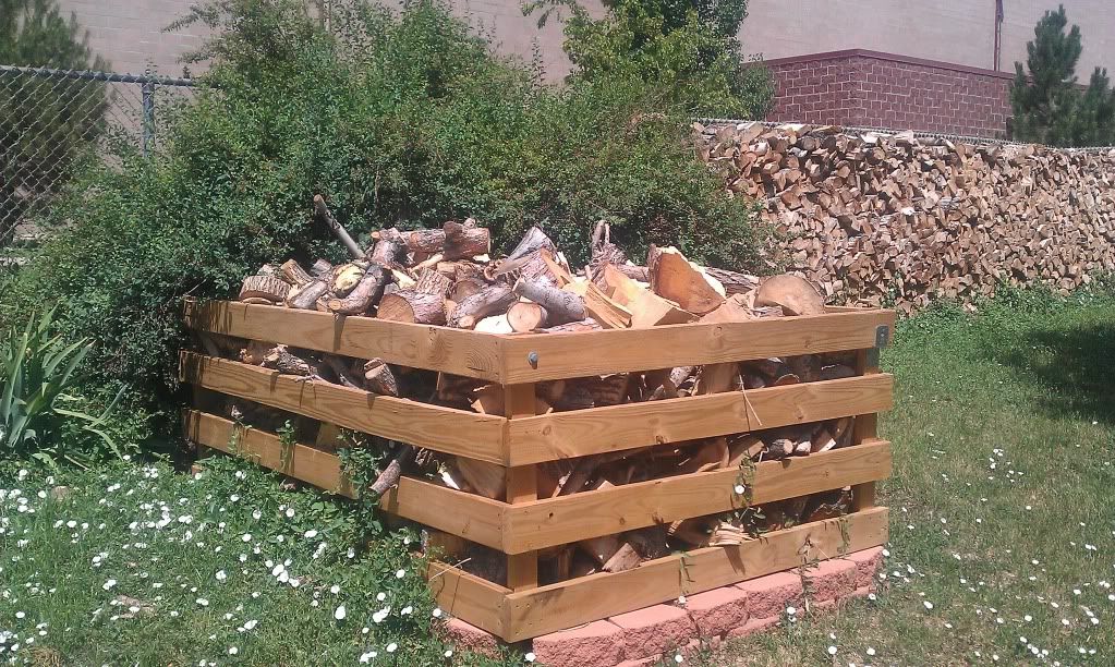

Bin from my previous home, will be building something similar at current property. I think it was around 9x5x4. Could swing front top post open for easier access. Pretty amazing how quickly you can fill up those bins.

Ok, I finally had time to get a few pics of my hog panel crates for y'all.
[Hearth.com] Shorts and uglies [Hearth.com] Shorts and uglies [Hearth.com] Shorts and uglies [Hearth.com] Shorts and uglies [Hearth.com] Shorts and uglies I guess I had forgot until I took these pics that I had screwed 2x4s down to the perimeter of the pallet to staple the bottom of the panels too

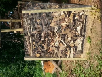

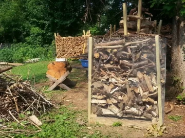

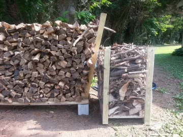

Picked up some 2x4 PT and decided to build a cage bin. I can't fit pallets in the Prius, too wide. I have a lot of galvanized screen left over I want out of the basement anyway.
Okay, so I slapped something together so I could get the uglies off the ground. It was only 1/2 full when I finished loading them, so I tossed some branch cutting on top.
That'll work! I could foresee some blood letting goin on there when diggin the wood back outta there though...::-)
yea, i realized that afterward. i'm thinking of cutting a "doggy door" near the bottom to retrieve wood from. I can always tie it back up with metal ties.
Doggy door and then teach fido to fetch the wood for ya, then you'd really have something! ;)
