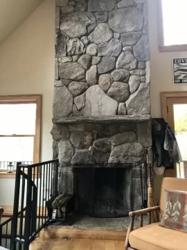

Anyways -- I have a dual-flue chimney that supports an upstairs fireplace, as well as a basement wood stove. Facing the chimney indoors, the upstairs fireplace is the right flue, and the basement stove is the left flue (see pics for context, which show my one-night temporary fix to block off the downdraft with aluminum tape...no more fires until I properly address the issue!).
Having looked both upward and downward, I'm 95% certain that each is independent of the other the length of the chimney, and for what it's worth, the basement is insulated.
I've come to discover that when I have a fire upstairs, smoke is going up that flue and down the other, causing the basement wood stove to emit smoke. I somewhat understand this is because there's a negative draw down to the basement, and that the stove flue stoppers and damper aren't fully sealing. I hope to fix that by to the best of my ability by disassembling the stove-to-chimney flue pipe and ensure that the inner damper can rotate to full-close, and to also redo fire ropes on flue collar & stove doors. I'm not sure if that will fix the issue, or if I there are other forces I should consider?
Could someone please speculate on the dynamics of my current issue / setup? And also give some council / guidance on how to best address?

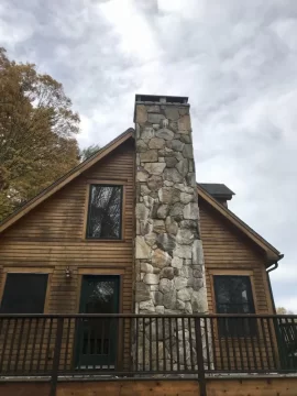

What does the top of the chimney look like?
Thanks for the response, Matt.
Here's an likely unhelpful picture of the chimney from the outside (won't be able to get on top until later today when I have a ladder spotter). Having been up there before, there are two distinct terracotta channels for each flue at the top, but that said, it doesn't truly mean that they're independent of one another (could be common below the top chambers).
Kevin

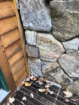

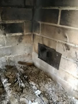

Flue extension is doable (I'd rather add an upper damper, if that's possible), but the downstairs OAK might be challenging. There's an OAK on the upstairs fireplace, but putting a proper one in the basement for the stove would take some doing (is adding one to the chimney post-construction even possible? I'd obviously have to do some serious masonry drilling). See pics of current OAK on the upstairs fireplace.
I'm not sure I follow your PVC pipe / valve suggestion (where would this be connected to?).

You shouldn't consider a basement OAK unless it's a walk-in basement. The outside air has to stay lower than the firebox at all points, which is not possible in most basements.
The PVC pipe I suggested would not connect to anything- it would only admit outside air into the room. It's a work-around for people who can't have an OAK for one reason or another.

From your outside chimney pic it looks like there are two separate flues that discharge into one big area created by that stone cap...if that cap could be cut in half and the one side raised (with a divider in between the two flues) I bet that would do a lot to remedy the situation...with it the way it is now its really just inviting this problem to happen!

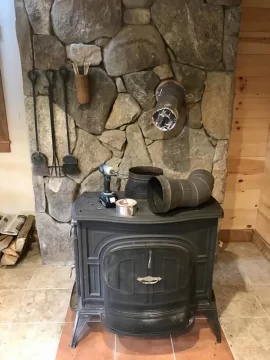

Sorry, All - - I just realized that in my original post I didn't include a picture of the basement stove (is now updated / shown).
Please feel free to chime back in if the calculus has changed with the new pic.

Thanks for the insight :) . I've updated the OP with pictures of the stove install. And yes, the stove in the basement is the primary heater, with the fireplace being decor / ambiance (IMO, running it for special occasions makes the heat / money it expends well worth it!).

I don't know what's going on in that stove's flue pipe, but it is nothin' good. (Maybe a black garbage bag stuffed in as a temporary air block?)
