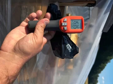

Shooting with a temp gun through the openings and the temp only varied around 5 degrees or so even to the middle of the stack. It was a little cooler on the North facing side but still in the mid 130s. I’ll probably pull a piece out in a few weeks and split it and check the moisture level.
