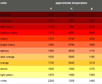

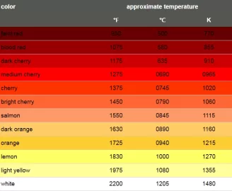

Color chart for reference from the hearth wiki:
https://www.hearth.com/talk/wiki/know-temperature-when-metal-glows-red/
How to tell what temperature a glowing object (metals) might be:
It doesn't really matter what the emitter is...stainless steel, cast iron, tungsten in your light bulb, the temps are about the same for a given color.

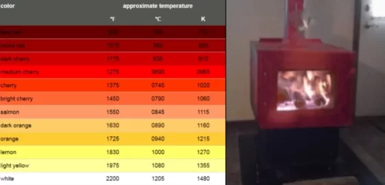

Looks ok to me.
Just peachy.
