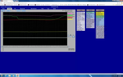

After re-plumbing the piping between Buffer and Storage tanks utilizing opposed circs I seem to be getting stratification now . Overnight the storage tank tops are still running temps of 174 or so instead of being 145 from top to bottom.. No more dhw shortages in the mornings.:cool: [Hearth.com] Stratification
