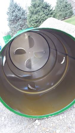

My son picked this up a few weeks ago from a local seller. I think it was $50. I would never have spent that much on burn barrel.
I'm glad he did! It works GREAT! Compare the ventilated area on this to a few 3/8" holes. I have more air coming in ONE of these cuts than a couple dozen 3/8" holes!
This thing burns hot and does not allow any sparks or embers to fall out. I'm sold!
