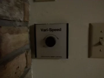

I should have included more information about my setup. Thanks for the replies.
My blower is built into the brick surround. And the wiring to the blowers is not accessible - behind the brick and drywall. I don't have the ability to get in between the blowers themselves and the control for them.
I am wondering if there is a wall switch to replace my current wall switch. I have seen timers for bathroom exhaust fans and am wondering if there is something similar where a longer interval could be programmed in.
This is my current switch.
Thanks for any other help.
Sorry. Forgot to attach picture. This is my current control knob.

Maybe look into the places that sell hot tub equipment. Many hotels have timers on their hot tubs and saunas??? Just throwing it out there.
Search "in wall timers", my folks had one by the front door that controlled the outdoor lamp post. i've seen programmable digital etc see links below, and old school ones that fit in an electrical outlet box.
http://www.amazon.com/Honeywell-RPL...XY/ref=zg_bs_6291360011_1/179-5485777-6793215
http://www.amazon.com/Best-Sellers-Home-Improvement-Wall-Timer-Switches/zgbs/hi/6291360011
Thanks! This is about exactly what I was picturing. One of them has a 90 min countdown which would nice. I will research from those on amazon and try one out.
