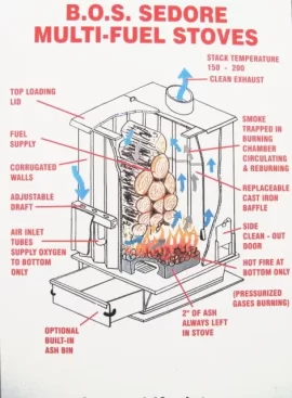

Sedore Stoves burn wet, rotten, and frozen wood well. Once the stove is going you can throw on nothing but rotten, frozen or wet/green wood, and it does so cleanly, with no catalyst's to deal with.

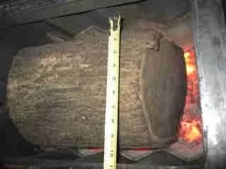

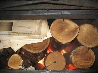

I don't have those fugures but the dry wood will be higher for sure. If you burn nothing but wet wood the stove is working a lot harder, air input increased. Like any stove it runs best on dry wood but once it gets a head of steam, it will burn any wood or wood product. I had my stove with a good bed of coals and tried this test. I cut a semi-green Oak stump I had to 19" wide 12" front to back and 25" deep. It was basically about a 65 lb solid chunk of wood. I put it in the Sedore and it burned for 33 hours. It was working hard to do it but just the fact that it did was amazing to me. Just getting a piece of wood that size would be impossible for most stoves? I've tried this on the 2000, and 3000 with approx the same results.
On another note, I don't do much wood splitting at all as I can burn the wood up to 12" in circumferance and it can be placed into the vertically. Top loading is so much easier for adding fuel and filling the firebox to the max. That has a good deal to do with the extended burn times for sure. see attached.
