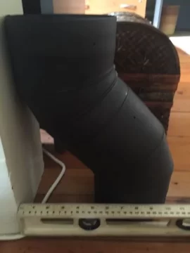

So, I call Rockford Chimney Supply, and wait on the phone while the guy on the other end of the line goes back to the shop and checks his various elbows. He says that two 45's give him exactly 9" offset, so I order them. Received, and I'm seeing 5" offset. One of us does not know how to measure...Looking for a combination of elbows (30's or 45's) that will give me a 9" offset, for the other.

Yeah, frustrating... but I have to admit this is very nice heavy single wall, with very clean welded seams and crimps. Even pre-drilled for screws! Definitely nicer quality than the garbage they sell at Lowes or Ace.The reason I only used those people one time. Sponsor or not.

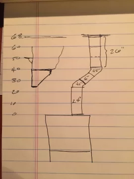

I would see if you can get it in double wall...I was going to try to put these dual 45's up at the block off plate, about 6' above the stove, if my clearances will allow for it. Then again, this 29' chimney surely sucks harder than BK spec's, so having the dual 45's right on the stove collar would probably not be a bad thing, on this one.
I could not find any offset tables on the Rockford site, but yeah... tan(45) = sqrt(2), so 6" should get me pretty close. If I call and order a 6" pipe, is that 6" effective length (i.e. 8" physical), or do I have to measure their crimped connector length and include in pipe length? Don't trust these guys to know what they have anymore, and would hate to use the tinfoil-thick riveted crap I can find locally. The Rockford pipe is very heavy, with welded seams... nice stuff.

Keep the stack warm...Just did some measuring. My CTC (if you want to call a timber lintel "combustible") is 17 inches, from existing vertical telescoping section to closest spot on lintel, with pipe connected directly to liner at blockoff plate. I need to jog that pipe 9" forward to mate up to the BK, and if I follow the initial plan of putting the jog up top at blockoff plate, I'll be down to 8" from lintel. Probably getting a little too close.
So, I could come up from stove with 24" straight pipe, then the elbows for the jog, followed by another 26" of height in a telescoping pipe. Shown below, this would keep me around 17" CTC.
If I went to double-wall, I guess I'd have more options. I'd lose my beloved surface thermometer, which I've been using the last several years on the single wall (very handy), but that's not a deal killer.
Thoughts?
