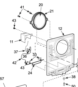

Have you looked at the older (pre-C3) versions of the Aspen? They had a sort of override/biasing mechanism to do what you are wanting to do. Not that any of those parts would fit, but it would be another design to look at for ideas.
Reactions: Todd and 30WCF
I have not seen that. I may dig around and see what that looked like.
Reactions: Todd
I know you will find these on your own but this may speed up your search a tad. If I understand correctly, you are just biasing the bimetallic coil/thermostat one way or the other - and lengthening or shortening the chain in that moment, while still allowing the thermostat to close down the air more as it heats up.
I think that would be the ideal way to do it vs. just manipulating the intake damper directly, like we are doing. It would require some non-sanctioned modifications to the mechanism at the back of the stove.
I have never owned a 1920 but I would suspect in the "High" burn rate lever setting, it was set to crack the intake damper very slightly open even if the thermostat was fully heated up? I'd be curious to know how much. I have thought about this a lot the last few years, especially when burning dry old mulberry as it seems to need just a tad more air than the Aspen C3 will give it with a fully closed intake damper in order to keep a good burn going. Then conversely the old dry American elm will absolutely take off before the damper gets a chance to close down. Being able to bias the thermostat either way would help with this.
Aspen 1920 Manual
Aspen 1920 Parts Diagram
View attachment 345738 View attachment 345739
